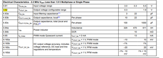

I'm trying to shrink down the design for the TPS6594-Q1 but after looking at the datasheet regarding the output capacitance, I was wondering if the capacitance "per phase" is referring to one voltage or for each buck used in a multiphase? For instance if Buck1, Buck 2, Buck3 and Buck4 are used in a multiphase configuration is it 22uF per buck or is it 22uF for all 4 combined?
