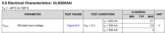

Could I use the 1.8v to driver the ULN2003AIPW ?
Hi Alex,
No, please see the below input high voltages for this part.
Please see TPL7407L/LA for use with 1.8V input voltage.
Patrick
hi Patrick
2.7/2.9v/3v is the max value for ULN2003, how about the Min & type?
thanks
Hi Alex,
What this specification means is that at least 3V is needed to always turn this part on at Ic <= 300mA. So min and typical do not factor in the same way. This part will not reliably turn on with VIN = 1.8V.
