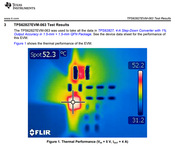

Dear Team,
I want to calculate the junction temperature of the TPS62A06DRLR on the TPS62A06EVM.
Can you please test thermal performance of the TPS62A06EVM under the following conditions?
 - Vin=5.0V
 - Vout=1.2V
 - Iout=4.0A & 6.0A
I want the following test results.

  • Hi Wemer-san,
    Thank you for the data.
    My customer is looking for a device that meets requirements of Vin=5.0V, Vout=1.2V, Iout=4A and Low price. And they are looking at the TPS62827DMQR first.
    From low price point of view, I think the TPS62A06DRLR is better suited, if the thermal performamce of it is better. Then, I have requested the case top temperature under Vin=5.0V, Vout=1.2V and Iout=4.0A & 6.0A conditions in order to compare the thermal performance of the TPS62827.

  • Hi Koshi-san,
    I measured the thermal images today for Vin=5V, Vout=1.2V Iout=4A and 6A. I let it settle for more than 30 minutes. The highest temperature at 4A is ~46.5 degree Celsius. At 6A it is ~ 68.2 degree Celsius. Ambient temperature was ~24 degrees.
