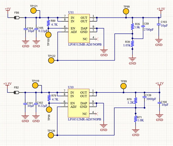

I have an input supply of 5V and I am using two LP38512MR-ADJ/NOPB, in series to generate 3.3V and 1.1V
For the first LP38512MR(U11) , I am getting an output of 4.8V instead of a 3.3V. Is it a stability issue or we can not use two LP38512MR in series.

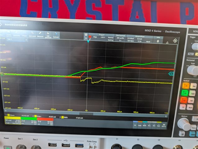

    2. Could you please share a picture showing your test setup and probing location? A scopeshot showing VIN, VOUT and IOUT will help
    3. What is the load current?
    1. Is this issue observed in simulation or post board assembly in hardware testing?
    Post board assembly in hardware testing
    1. Could you please share a picture showing your test setup and probing location? A scopeshot showing VIN, VOUT and IOUT will help
    Yellow= Iout, Green =Vin, Orange=Vout
    1. What is the load current?
    Less than 1A.
  • As per the orange trace (VOUT at 2V/div), you seem to be getting 3.3V at the output. Could you show me where you are seeing 4.8V on the output or if I am reading something incorrectly from the scopeshot above?
