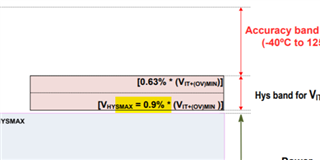

Hi team,
VHYS is specified as 0.75% typical and 1%max, 0.4%min in the datasheet.
0.9% is selected as below in TPS3704 excel calculator as below and is not used as user input value.
Could you advise why 0.9% is selected?
