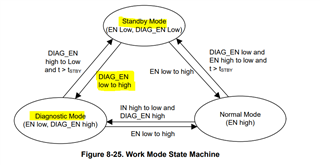

Hi team,
How much delay is in transition from "Standby Mode" to "Deagnostic Mode"?
Ochi
Hi team,
Ochi
Hello Ochi-san,
The transition time between these two modes is 150us this is displayed in the datasheet in the SNS timing characteristics table as tSNSION3.
Alan
