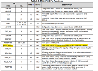

    The TPS25730 has 6 GPIO set functions, one of which is PLUG_EVENT tied to pin 37 (this will indicate when a USB connection is present).
    If you would still like more configurability, then I do recommend the TPS25751 for your application.
