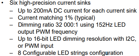

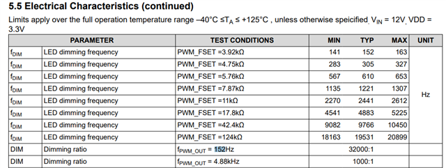

I would like to check why LP8866-Q1 dimming ration is 32000:1 when fpwm_out = 152Hz?

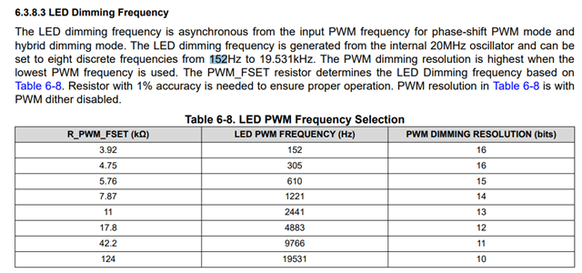

In datasheet, we can achieve 16bit when LED PWM frequency set as 152Hz. Why we only declare "Dimming ratio 32 000:1 using 152Hz LED output PWM frequency" instead of "Dimming ratio 65535:1 using 152Hz LED output PWM frequency"?
