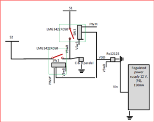

Can you help us evaluate this concern from customer using LMG3422R050 in switched-capacitor circuit?
See attached the description of my question in details to this email. This is confidential.
LMG3422R050_TI.pdf
How much current should I consider for the 12V bias of the LMG3422R050 gate driver when using a 12V DC-DC converter to provide it?
Additionally,

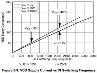

Is 12-V bias of LMG depends on the amount of voltage at the drain of GaN devices, S1 and S2? Additionally, I looked at the LMG3422R050 datasheet. There is a curve showing the current consumption of the LMG at different frequencies. For higher frequencies, the current consumption Increases.
For high frequency about 1 MHz, how much current should I consider for VDD-12-V bias voltage?
Thank you for your guidance.

    Here is additional information provided:
    I am providing PWM through FPGA and digital isolator.
    I reduced the PWM frequency to 100kHz. The 12V bias power supply with 90mA current limit didn't drop. To verify the LMG3422R050 functionality, I checked fault, OC, and temp output for each LMG3422R050. Fault' output remains at high. However, OC' output remains low and Temp output turns on for one PWM period,10us, every 160us.
    The current limit at S1 and S2 is 30mA.
    Would it be possible to let me know Why short circuit occurred in the circuit?
    After completing test at 100kHz, I will increase the frequency and current limit at 12V bias to verify the functionality.

    VDD quiescent current is typically 700 uA, this assumes 12V Vdd, Vin 0 or 5V, and no current consumption from LDO5V. Also, figure 5-9 shows the supply current vs IN switching frequency:
    These both assume that no current is pulled from the LDO5V pin. These values are what we expect to see from the VDD pin, therefore if we see something much higher, it most often is related to some peripheral circuitry pulling more current than expected, or improper operating conditions.

  • Hi Zach,
    Thank you for the detailed response. Here is the follow up:
    How is the 14mA of current from the DC-DC converter measured? If this value is from the datasheet, it could be possible that the converter is consuming more current.
    14mA is measured in the lab using multimeter in series with the DC-DC converter Input while the output of DC-DC converter is disconnected from the rest of the circuit.
    Is there any circuitry connected to the LDO5V pin?
    Yes, the LD05V is connected to the two digital isolators, ISO7760FDBQ, which provide PWM for the LMGXX. I copied the exact schematic with the same component values as proposed in the LMG342XEVM-04X User Guide.
    1. Can I remove C10, C2, R3, and R4 from the circuit if I connect VCC1 directly to the 5V power supply?
    2. Is the rest schematic correct in my application? Do I need to do any modification?
    Is it possible for the customer to remove the DC-DC converter and supply VDD using power supply directly? This will help us narrow down the problem device.
    I will try and let you know.
    1. Would it be possible to let me know if there is any way to determine the issue with the LMG3422R050 in the below case:
    The fault signal was at a high level, and I was able to measure the expected output voltage. However, after working on the circuit for about 30 minutes, the output voltage fluctuated significantly. I didn't change anything in the setup. To find the problem I added two resistors—10 Ohm and 0.02 Ohm—in series with S2 and S1, respectively, to limit the current and make it possible to measure the voltage variation at the drain of SW2. I found that the LMG3422R050 shuts down randomly when the capacitor is charging. Sometimes, when the PWM signal is at a high level and is supposed to be drawing current, the GaN transistor inside SW2 switches off, causing the drain voltage to return to 6V, the same as at S1.
    The circuit specifications are as follows:
    power supply at S1: 5V, 60mA
    power supply at S2:6V , 110mA
    PWM freq : 100KHz
    The output waveforms are attached below.
    Thank you.
    Archie A.

    The follow up above has been solved already. No need for further action. Here is the new query:
    Just I would like to ask you to let me know the following questions:
    1. Does HV-S1 affects HV-S2 if I use just one digital isolator to provide the PWM signals for both switches? I've  just connected LD05 pin of SW2 to the power pin of the digital isolator. However, when I increase the voltage at Hv-s1  with out touching HV-S2 , the power supply at HV-S2 increases from 5V to 5.5V. I checked LD05 pin of both switches, both shows 5V.
    2. what may cause the above problem? because there is no trace outside both switches to connect HV-S1 and HV-S2.
    Thank you in advance for your support.
