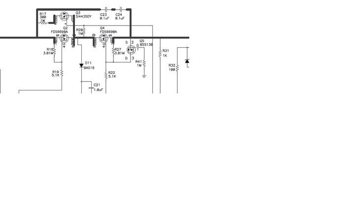

Kindly help me in below issues:
1. What is the max design cap  . It is 32767MAH or 65535mAh.
2.I gave a learning cycle to my battery & it reported 13200mAH FCC & 5% max error. Then I used it in my application but after 2- 3 days, it reported 5120mAH. Why FCC reduces. But then I calibrated my PCB by "CC OFFSET CALIBRATION" & it again shows 13200mAH.?
