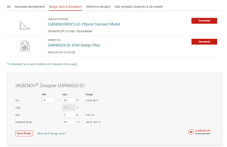

Hi team,
My customer want to do 5V output simulation. But seeing from product page, there is only 3.3V output simulation model.
Can you provide 5V model or teach me how to do if there is not 5V model.

  • Hi Youhei,
    I was able to get the PSPICE model to output 5 V. You just need to put an appropriate resistor ladder on the FB pin in the model. You may also need to change the inductor to a more appropriately sized one according to equation 7 in the datasheet. You will also want to change your output load resistor (the model has it as 3.3/2 but you will need to change it to 5/2 for 5 VOUT, 2 A operation).
    You can also use webench to quickly estimate parameters such as efficiency and bode plot stability if you are having trouble with PSPICE. Select the adjustable or fixed 5 V version of this model to simulate a 5 V output. I have created a design for you as a starting point for your convenience: WEBENCH LMR43620-Q1 5 VOUT.
    A caveat is that these simulation tools are provided to help but are only estimations on performance. TI recommends conducting further bench validation on your end to ensure the device is operating as expected with your application's parameters before moving forward with the design.

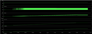

  • Hi Joshua,
    Understand. However my customer couldn't output 5V, could you review their condition below?
    Youhei
  • Hi Youhei,
    I understand the issue. It seems that the PSPICE model is built with a 3.3 V reference voltage. You can achieve 5 VOUT using an adjusted resistor ladder that is different from the datasheet
    Please keep in mind that this design for you resistor ladder will not be applicable to the bench as the device has a 1 V reference voltage, but this should be ok for the soft start/transient analysis. Should you need further analysis, you can use webench to simulate 5VOUT. Here is the design I have started for 5 VOUT operation with the fixed version of this device: https://webench.ti.com/appinfo/webench/scripts/SDP.cgi?ID=BDC46A19713B04AE
