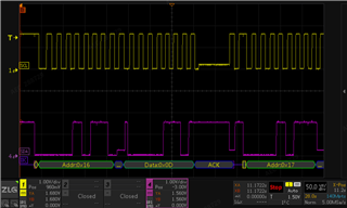

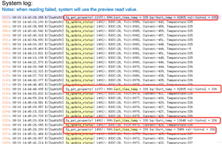

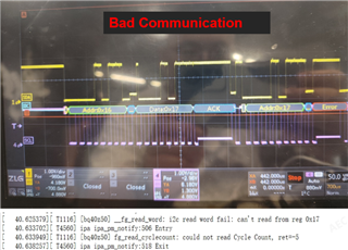

Our customer found communication data loss during test and it happened frequently. System read battery information every 5s and there're about 37 error during 30min.

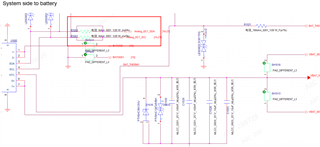

Also here attached both battery and system side schematic and oscilloscope capture when good and fail reading happend.
Is there any clue what might casue this issue? or shoud I include more information for analysis?
Thanks very much.

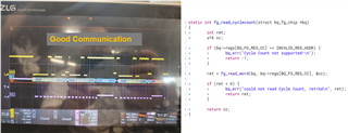

  • Hi Anthony, there's the screenshot of the bad communication in the orignal post, is this helpful?

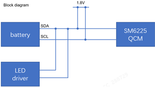

    Also our customer mentioned simulated I2C method with qualcomm SM6225, do you think it will have issues with the SMBus v1.1 compatible interface which is supported by bq40z50 chip?

    It is difficult to confirm the exact values if we cannot zoom in and check the actual time values in the scope shot, however I believe this should be fine since there are previous commands being sent with this structure that are working. Is there a possibility that there are collisions on the communication lines that are causing this issue since it is being sent every 5 seconds?
    Anthony
  • Hi Anthony, our customer tried to remove all the other components only leaving battery on the communication line, these errors still exist, so it might not be collisions.

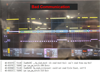

    Also, they send the error message and the oscilloscope screenshot of the bad communication

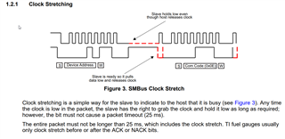

  • Hi Long,
    The screenshot above seems like the gauge is using clock stretching seen below:
    Has this been tested yet with the FLASH_BUSY_WAIT bit enabled to see if it alleviates the issue?

  • Tried to change the communication frequency to 400KHz on both system and battery side (XL bit  in SBS Configuration), it seems like this problem disppeared.
