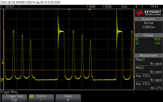

as described in the related thread I'm working on a booster that starts from 48V and provide an output that can be adjusted from 100V to 250V.
At 250V the maximum current output should be 1.2A.
I designed the booster using the quick start calculator, I choosed DCM operating mode to avoid very low sense resistor (that suffer parasitic resistance of reflow soldering).
I'm attaching the schematic.

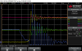

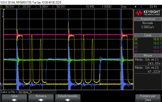

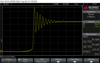

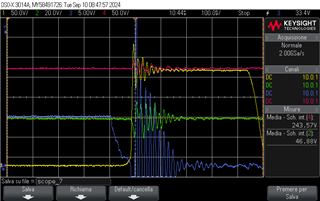

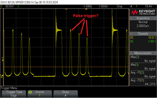

Checking the prototype I have a couple of issue:
- Switching node ringing (I tried with 10ohm gate resistor without good results), I'm attaching the mosfet Vds measurement with 10ohms gate resistor.
- Overheating of the inductor and the mosfet. I can choose a lower resistance inductor, but the mosfet have a good rds on. Also I'm using an external 12V on the VCC pin.
Can you help me to solve the issue above? Any suggestion to improve the overall performance?
