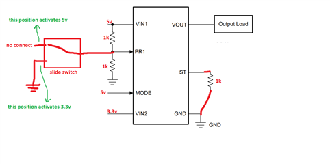

the design is simple, i have 5v source and 3.3v source which i need to switch between them using a slide switch.
I need the switch to never short the 2 sources and only connect one.

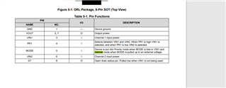

the circuit I suggest is to have 5v go to IN1 and 3.3v go into IN2. MODE is connected to 5v all the time.
5v has a voltage divider of 1k || 1k resistors, which the divider is connected to PR1. please check the image below
high quality full res image here: https://slow.pics/c/ico5gzld
is this circuit fully working properly??
as seen, the switch has 2 positions: no connect and GND.
when at no connect, the resistor divider will stay the way it is delivering about 2.5v to PR1 which activates 5v.
when at GND, it will pull PR1 pin down to 0v which will disengage 5v and activates 3.3v.
is this correct?
should i use the circuit or does it need modification?
