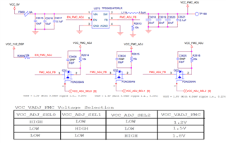

Hi Team,
Using the part TPS565247DRLR, we need to generate 3 different output voltages, by keeping a single 10k pull-down resistor and adding the respective pull-ups with the help of NPN transistors.
Below is the circuit design.
The processor controls the gate pins of the transistors.
Input voltage for the regulator = 5V
Output current/voltage 1 = 4A @ 1.2V
Output current/voltage 2 = 4A @ 1.5V
Output current/voltage 3 = 4A @ 1.8V
Can anyone please give feedback on selecting the output voltage using these NPN transistors.
Can the selected input capacitors, output capacitors and output inductor, meet the requirements of 3 different output voltages?
P/N of output inductor (1.5uH) = XAL4020-152MEC
P/N of output capacitor (22uF) = GRM21BR61C226ME44L
P/N of output capacitor/input capacitor (0.1uF) = GCJ188R71H104KA12D
P/N of input capacitor (10uF) = CGA4J1X7S1E106K125AC
Thanks in advance!
  • Hi Sam,
    First, I see FDN339AN is NMOS not NPN transistor you said. Please check this. Then, this solution is not good. We recommend keep same pull-up resistor and use NMOS to control pull-down resistor. In your case, You can keep 20k pull-up resistor, and one 20k pull-down resistor for 1.2V, and turn on MOS1 to parallel 60k for 1.5V, and turn on both MOS1 and MOS2  to parallel 60k and 30k for 1.8V. Thanks.
