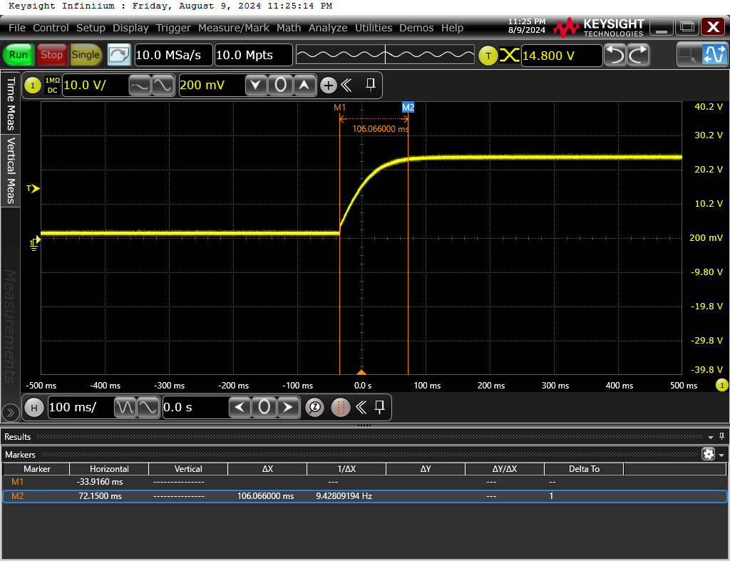

I am using the 2x LM74810QDRRRQ1 to drive a 24V two-speed motor.
The first LM74810QDRRRQ1 drives the speed1 wire when enabled.
The second LM74810QDRRRQ1 drive the speed2 wire when enabled.
The EN/UVLO pin is used to enable/disable the relevant LM74810QDRRRQ1.
I have found that the motor induces a voltage into the undriven wire.

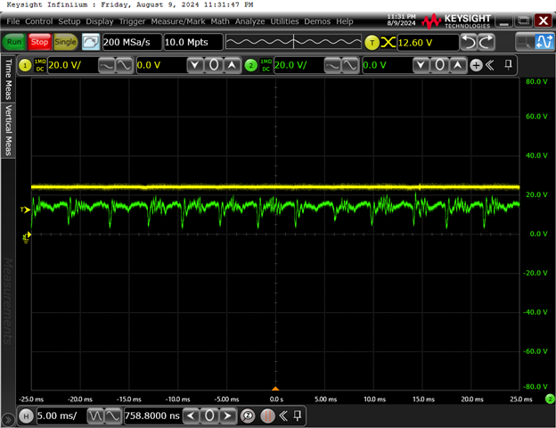

(1) speed1 output is on, speed2 output is off
The motor induces a voltage into speed2.
Yellow is speed1 and green is speed2

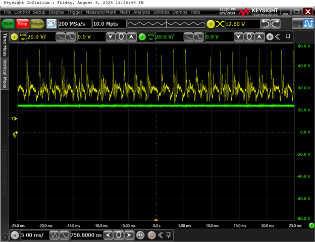

(2) speed1 output is off, speed2 output is on
The motor induces a much larger voltage into speed1.
The datasheet specifies a maximum voltage of 70V for the C, VS and OUT pins with respect to GND.
Is there anyway to increase the maximum voltage rating or do I need to look for another solution.
Any comments and thoughts would be greatly appreciated.
