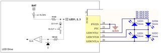

Can you tell me the BQ40Z50 LED driving method?
What is the driving current?

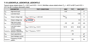

LEDs are push-pull pins.
Looks like each LED will drive around 1.5mA.

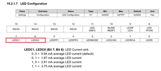

Hi Mulin,
That is the power consumption when each LEDs is ON. Looks like 0.94 mA per LED.
