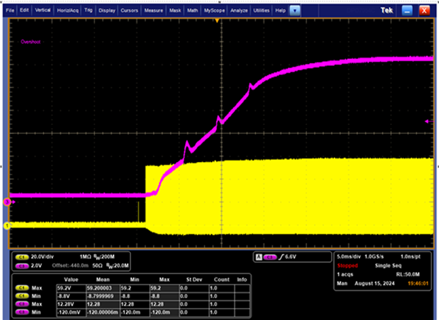

Customer tested the power on waveform of TPS54561. CH3 is vout, CH1 is SW. There are many bumps on Vout, could you please explain the reason? Could you please reproduce it on EVM?

    My suspect is, this could be due to frequency foldback effect that we have in TPS54561. A frequency foldback circuit reduces the switching frequency during start up and overcurrent fault conditions to help maintain control of the inductor current. Under startup light or no load condition, since the frequency is changing by 1/8th, 1/4th of RT frequency, there is possibility that overshoot could happen at the output node.

  • Hi Nitya,
    Input voltage is 54V, output voltage is 12V, max Iout 4.3A.  fsw=450kHz, Tss=13.5mS.

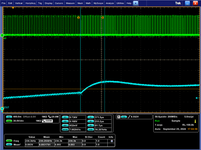

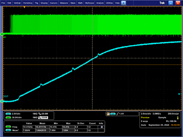

    1. This is not strange waveform. This is expected during frequency transition from Fsw/2, Fsw/4, Fsw/8. This is tested on the EVM as well.
    2. The theory of operation is briefly explained above.
    3. The bump-up of the output voltage during frequency foldback is within the output voltage settings. It will not cause any issue during steady state operation.
    Nitya
  • Attaching zoomed in waveform as well during frequency foldback transition.
