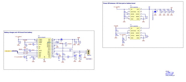

  • Hi Manuele,
    Can you please share your device schematics?
    Juan Ospina
  • Hi Juan,
    of course
    Thank you for sharing the schematic. I'll take a look to see if I identify any issues with it. There is a few more questions I have:
    - What is your battery voltage at this time?
    - If possible, can you please share a waveform of +V5_BQ and +V5_Supply before you enable OTG and once you try to enable it? Based on the REG08 there appears to still be voltage present on VS (Power Good is set).
    - Even after a 220mS wait, if you readback the register value it is still 0x1B?

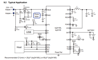

    Also, please note we typically recommend this kind of isolation circuit at VBUS  if OTG is being used. This is to prevent power from reaching the power source and to ensure that the device OTG works as intended:
    Juan Ospina

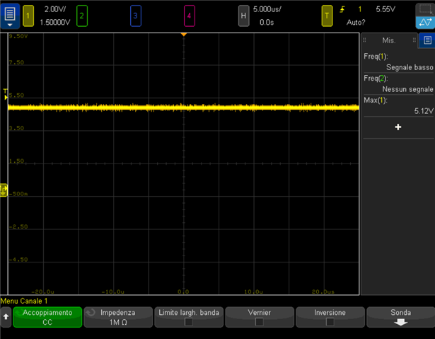

  • What is your battery voltage at this time?
    4,19V
    +V5_BQ before
    +V5_BQ after
    +V5_SUPPLY
    Yes

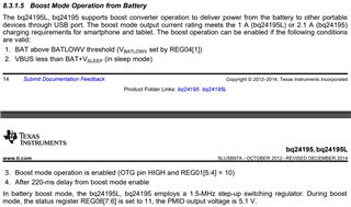

  • Hi Manuele,
    It looks like there is still 5V present on VBUS before you try to enable the boost mode on this device. One of the requirements for entering boost mode is that VBUS must be less than VBAT+Vsleep.
    Is your VIN still present when you attempt to enter boost mode?
    Juan Ospina
