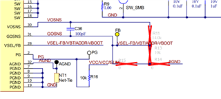

    To use the external divider, a few steps must be taken:

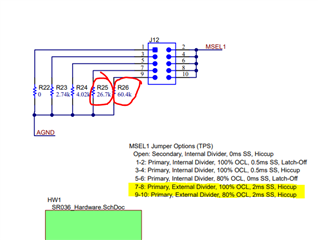

    • Ensure the J12 or MSEL1 is set to "External Divider" resistors

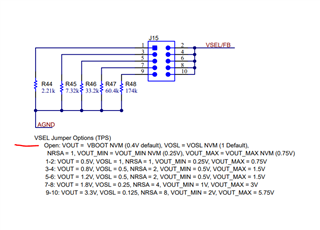

    • Ensure J15 or VSEL/FB jumper on EVM is open. For  VSEL/FB pins external divider, the Vref is 0.4V so for 1.25Vout. top feedback resistor should be 21 kohm and bottom feedback resistor should be 10kohm.
    • In the image below, R15 should be populated, and R11 and R13 are populated with the feedback resistors.
    Hope this helps!
