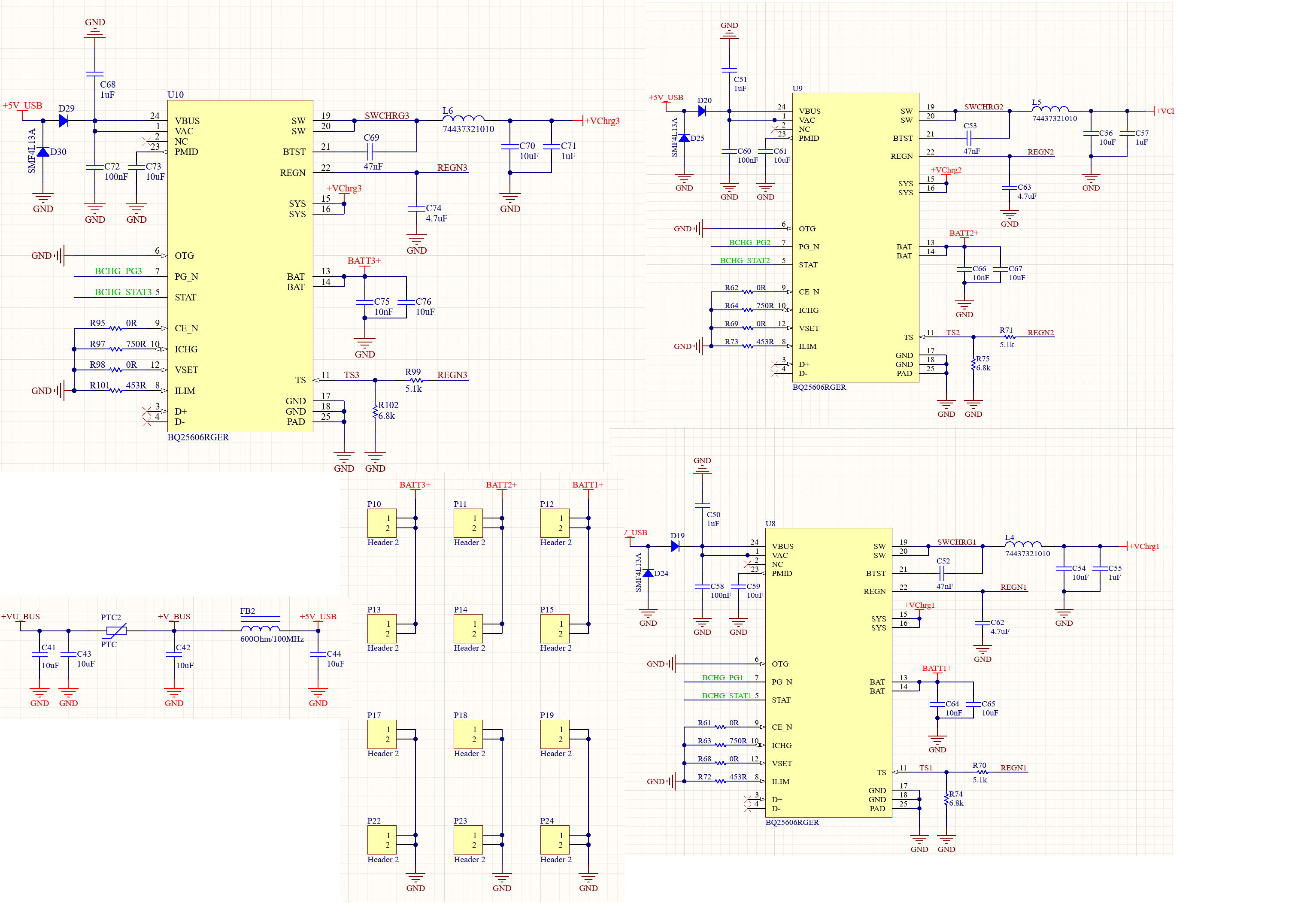

Hello Everyone,
I am designing a Li-ion battery charger with three battery compartments.
I have split the three batteries and used three BQ25606 ICs.
I have set the charging current to 900mA using Rch, and the current limit to 1.1A, for each independent charger, and here comes my problem, the input current for all the chargers (in charging) dose not exceed 900mA for all the chargers, which is not supposed to.
From my understanding, if I connected them in different voltage busses, each charger should limit itself to 900mA.
Please see the below schematic for my circuit:
