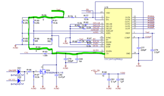

In TIDA-020031, CS pin is connected to Vref through a 0 ohm resistor. Please could you explain why is it connected to Vref in parallel with the current transformer output?
Please see image below:
Thanks for sharing the original schematic. The Vref pin should not be connected to the CS pin and this is a mistake.
The tida-020031 has been removed from TI.com due to errors in the schematic. Sorry for the inconvenience.
The following link will get you to a UCC28950 600 W evaluation module user's guide that has a complete schematic, that shows how to connect the CS pin up correctly in a phase shifted full bridge.
https://www.ti.com/lit/pdf/sluu421
