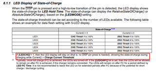

1.Hi whilst charging my Pack from RSOC 0%
I noticed that the LED blinked quicker from 0% to 10%
Any reason for this ?
2Secondly whilst going through the gg file
it says flash alarm RSOC 10%
Are these two items related

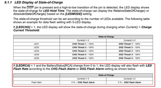

    Do you happen to have the LED PF Code functionality on? This has two different blink rates that might be causing this:
    For the CHG Flash Alarm and DSG Flash Alarm, they are based on the current being seen at that time:

    Anthony:For the CHG Flash Alarm and DSG Flash Alarm, they are based on the current being seen at that time
    • What does Flash alarm indicate ?
    • the only current being seen is the charge current so hows this flash alarm set ?
    The flash alarm indicates where the SOC is at based on if a charge current or discharge current is being seen. For example, if the DSG Flash Alarm is set to 5%, and there is a discharge current is being seen, the LED will flash if the SOC is between 5 and 0.

    I believe the LED PF functionality is enabled by the LEDPFON bit seen below. The LEDPF1 and LEDPF0 are configurable settings for it
    • And this LEDPF indication is there to designate the failure being seen by the pack?
    anthony:The flash alarm indicates where the SOC is at based on if a charge current or discharge current is being seen. For example, if the DSG Flash Alarm is set to 5%, and there is a discharge current is being seen, the LED will flash if the SOC is between 5 and 0.
    • This value is set at 10% for our Pack
    • I'm guessing this means when in 0-10% range the pack will flash to indicate "low battery" essentially,i've seen this in practice for our Pack
    • For DSG CHG alarm i have not seen this as our pack only blinks when charging ?

  • Hi Jonathan,
    Correct.
    Correct, when the SOC of the gauge is less than 10% and in DSG mode, is this blinking still not being seen?

    For clarification, is the [LEDCHG] bit set in this application or is the LED being turned on using a high to low transition on the DISP pin?
    Anthony
  • Hi Anthony,
    Anthony:
    • not sure about those bits but essentially our LED only shows when we're charging, we only have one LED!
    • LED does not display during discharge or normal operation only when charging!

  • Hi Jonathan,
    The reason I ask about the LEDCHG bit is because if this bit is set, the LED will stay on while the current is greater than the Charge Current Threshold with nothing needed from the DISP pin, which if this bit is set this would make sense why the LED is flashing during the charge and not discharge.

  • Hi Anthony,
    I was able to look at the flags for LED ,and it was indeed LEDCHG, meaning it will be ON as long the charge current is greater than charge current threshold

  • Hi Jonathan,
    If LEDCHG is enabled, this allows for the gauge to not need a high to low transition on the DISP pin to display the LED status when the gauge is charging, however not for discharging. I believe that this transition on the DISP pin is required when the gauge is discharging.
    Regard,s
    Anthony
  • Hi Anthony,
    Anthony:
    • Can i change this setting on BQstudio to see LED during discharge ?
    Jonathan Kabangu
  • Hi Jonathan,
    I do not believe this LED can be turned on without the high to low transition on the DISP pin while discharging.
