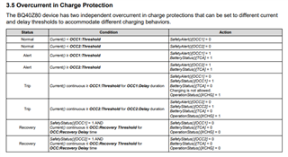

Using the bq40z80 evm board, can charge and discharge the battery. I do not have any issues with it. I need to find the current flowing across the SRP and SRN terminals using bqstudio, how to achieve this?
And I need to control the charging current how to achieve this using bqstudio?
I need the charging current not to exceed 4 A for example. I can change the protections value in the data memory of the bqstudio. How to test it?
