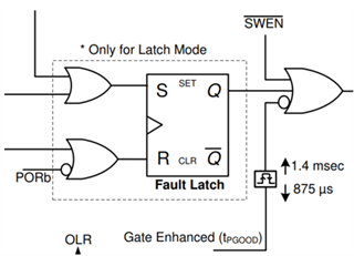

Also, the data sheet states that it is designed to eliminate erroneous signals using a "de-glitch." Is the following a correct "de-glitch circuit"?
Could you please briefly explain how it works?

    Q1:Check the "9.3.5.3 FAULT Response" section from datasheet for working of PGOOD de-glitch circuit. It's to provide a time delay before asset the PGOOD which is used to enable downstream DC-DC.
