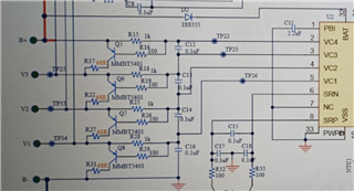

My customer met a question in 4S1P LFP cell. Full charge V=14V(3.5V per cell).
Set V term=150mV, I term=200mA. RSOCL=1.
However, due to the poor cell consistency in LFP, some cell will reach 3.7V first and trigger OVP before valid charge condition meet. Current > 200mA, RSOC=99% at this time.
Is any configuration could help on this situation?
