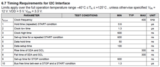

My customer have a question regarding the LP8866QDCPRQ1 LED Backlight Driver Timing requirements for I2C Interface.
Here is the table from the lp8866-q1_102020 datasheet.
According to the datasheet, the maximum Clock frequency is rated up to 400kHz.
In their design, they have set the I2C SCL clock frequency to 100kHz.
Their question is, since they set the SCL frequency to 100kHz instead of 400kHz, can they still follow the Holdtime/Setup time listed in the above table?
