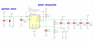

    • Schematic is per the Web bench design.
    There are a lot of webench design based on TPS61021A. Please share the schematic and layout directly.

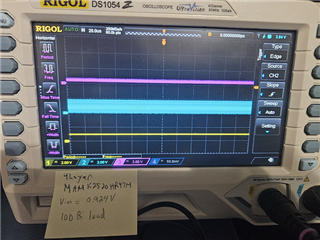

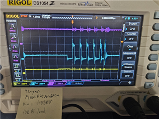

    • However, in testing, with the circuit hooked up to a bench supply, even 35mA drags the output down to 3.2V when the input voltage goes below 1.4V
    I would like you to capture the waveform of Vin, SW Pin, Vout. Place the waveforms in the same screen. Capture one waveform of 1ms/div time scale and another waveform of 20us/div.

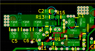

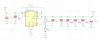

  • I will capture the waveforms and post them.  Here is the original application board.  It is a 4 layer board with the +vbatt coming in on the power layer (not shown) and was designed with the MAMK2520HR47M as the inductor.  The 10uF are CL21A106KOFNNNE.

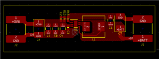

    Part were swapped out for the ones listed above, however the larger inductors did not fit well, so I created some simple l layer test boards that followed the layout in the datasheet exaclty.
    C7 and C8 were just in case I needed bulk capacitance from the test lines.  They are not populated, neither is C6.  C1, C3 and C4 were populated with  2012X7S1A226M125AC.  Two identical boards were created with different inductors only: MHE0503R33M-10 (330nH, 19.2A, 3.6mOhm) and AIP0530GX-1R0MPBDG (1uH, 10.5A, 8.5mOhm).

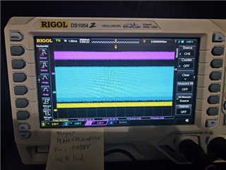

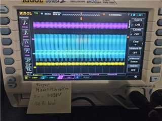

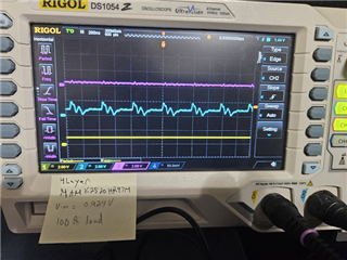

  • Got slightly different results with the oscilloscope vs. multimeters.  Some better, some worse.  It got slightly better when nothing was connected to SW.

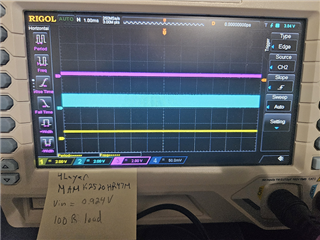

    Would not start-up until the voltage got over 1V.
    The 100R load is ~35-36mA.  This board won't even start at 1.6V with a 17R load (~211mA).  The 1 layer test board with the MHE0503R33M-10 (330nH) will start at ~1.2V with the 100R load and will not start up with the 17R load.  The 1 layer test board with the AIP0530GX-1R0MPBDG (1uH) has not issues with the 100R load, but will only start up with the 17R load at around 1.5V.  This is worse performance than with the multimeter.  However, the multimeters reduced the load current from ~211mA to ~171mA, so that may be the reason.  When the circuit won't start, the traces looks like above at 0.924V.

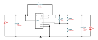

    WEBENCH is giving me this when I input Vin = 0.9-0.9V, 3.6V Vout @ 0.250A:
    On the test boards, I'm using the recommended 22uF output caps (2012X7S1A226M125AC) for all three 22uF caps and inductors that exceed the specs of the one listed.  I used a 348K resistor vs. the 357K, but that should be easier to meet since it lowers Vout slightly.

  • Hi Kris,
    Sorry for the late reply. I wasn't in the office last week. I've tested on my bench and 100ohm load is close to the IC maximum start up ability. The device current capability during start up phase depends on Vin. So we recommend reducing load during 0.9V start up or choose TPS61299. TPS61299 has less current capability after start up but the current capability during start up is stronger than TPS61021A.
