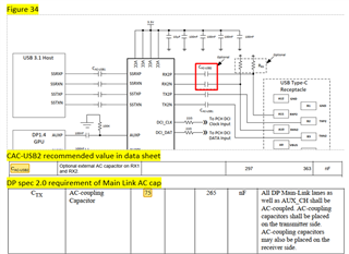

    Referring to figure 34 of datasheet, it recommends the value of this cap within the range from 297nf to 363nf.
    When TX2P/N and RX2P/N configured as DP port, I checked the DP spec, the recommend value of AC cap is in range 75nf to 265nf, I can’t find a value meet both DP and datasheet requirement, so CAC-USB2 is USB port only?
    Customer's concern is if the CAC-USB2(330nF) will impact the DP compliance test when RX2P/N or RX1P/N is configured as part of DP port since the AC cap should be in the range in range from 75nf to 265nf defined by DP SPEC.

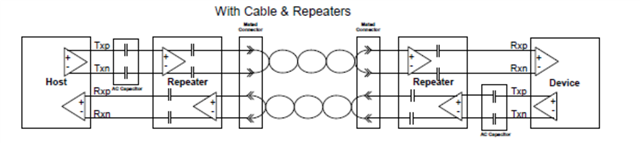

    But for DP Alt Mode over Type-C, there will be a capacitor at the sink or device side as shown below.
    The capacitor at the sink or device side will be 100nF or 220nF.
    With 330nF on one side and 100nF or 220nF on the other side, the total capacitance is  = 1/ (1/330 + 1/100) = 76nF. The 220nF will push the total capacitance a bit higher, but both 100nF and 200nF will ensure the capacitance is within the DP spec requirement.

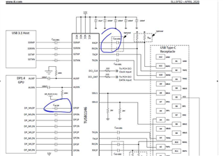

  • Hi Shane,
    Thanks for your backup. But the customers concern is actually the AC caps on the two sides of the TUSB1146. If the capacitor value will be too large or too small that exceed the PD specification. Can you double check on that?
    Han
  • Hi Han,
    It's ok to have capacitors on both sides of the TUSB1146. Each side of the 1146 should be treated independently, not as a single line. This means in an actual system application you're ok as long as:
    • The capacitors between the TUSB1146 and the DP source fall within the DP spec (75nF - 265nF)
    • The capacitors between the TUSB1146 and the USB-C connector fall within the USB-C/DP alt mode spec
      • TX1/TX2 lines (recommend 100nF - 220nF)
      • RX1/RX2 lines (recommend 330nF)
    I see your concern with the RX1/RX2 capacitors being too large when compliance is taken at the USB-C port. I believe the compliance test would be ok given that we recommend these capacitor values for type-C applications, but let me follow up with my senior colleague when he's back in the office on Monday to be sure.
    Shane
  • Hi Han,
    I followed up on this concern with our systems engineer. There should be a USB-C DP alt mode compliance test that factors in the 330nF capacitors on the RX lines. Like you mentioned, capacitors on the RX lines must be between 297nf to 363nf.
    If you're running the USB-C DP Alt-mode compliance test, there should be no issue with these capacitors.
