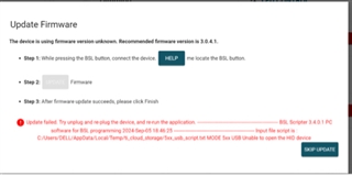

Customer installation NVC245-LP586x family Graphical User Interface Matrix LED driver installation failed,
There are the following prompts, thanks.
Hi Ken,
It's the problem of USB2ANY software, it needs to update the firmware version.
Please follow the information in the "HELP" button, you need to plug and unplug the USB2ANY while pressing the BSL button on USB2ANY.
BR, Jared
