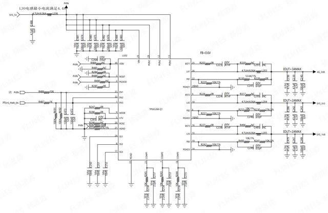

Customer use our TPS65268 in one of their project, All the 3 buck DCDC in TPS65268 is in normal operation, but the IQ performance is out of our spec.
From our spec, when only buck 1 in working(EN1=high, EN2=EN3=low), the IQ of our Buck 1 is 590uA_max. (590uA base on 2M fsw from our datasheet)
But in customer PCBA,  customer found the IQ(IQ means Iin of the Vin pin) is bout 3.4mA. 3.4mA is much higher than our spec 590uA. (EN1=high, EN2=EN3=low, Vout1=3.8V)
customer using 900K fsw, if they using 2M Fsw(2M Fsw is our spec test condition), customer feedback that the IQ is worse than 3.4mA.
Could u help to check the case? And do u have any EVM board to test it? it seems there is no TPS65268EVM in TI system.
Thanks.
