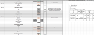

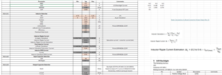

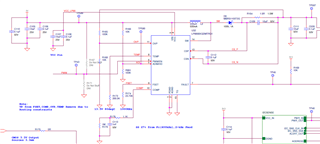

HI,
Attached is my design.
Issue is when i increase PWM the inductor ripple increases, and the input voltage drops below 4.6V.
Using in PWM Mode
Am suspecting
1. RCOMP,COMP,RDAMP Values
2.RTH
3.INput capacitance
Inductor calculations are fine i my belief
