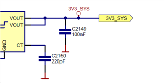

can you please provide help on review for PMIC schematic? It shall be used with a AM62A74 SoC.
I have additional questions regarding the hardware configuration.
As we use three-phase configuration:
  1. FB_B3 can be used for voltage monitoring?
  2. Can it be left floating?
  3. How is it configured?
Thank you very much in advance.
Greetings Daniel

  • Hello Daniel,
    My comments/concerns are as follows:
    PIN49: To answer your question about FB_B3, it does indeed need to be connected to a voltage source, it is recommended to connect to the TPS22965N as shown below
    PIN14: nINT is an open drain pin, needs a pull up as noted in the checklist you provided, just making sure it's been brought to your attention.
    PIN 51 & PIN 52: Please be sure to ground these as per the recommendation of the datasheet, I see that the checklist has these listed different functionality please ignore those line items. When GND please do route them to the thermal pad, try to connect to a solid ground plane if possible.
    PIN 5 & 6: Please try to route these to a solid ground plane as well. DO NOT route these to the thermal pad.
    PIN 46: GPIO3 if the IO + DDR retention is not an option you care for this does not need to be implemented.
    PIN 23: GPIO5 is the selection for the voltage for the SD card since it is optional and not being used this can be ignored.
    PIN24: GPIO6 selection of voltage as pulled up, will be 0V85 on VDD_CORE
    PIN 41: GPIO8 Watchdog will be disabled by default with PU resistor populated as stated in the checklist.
    PIN19: GPIO9 is edge triggered, net will have to drive this after power up has occurred for LDO2 functionality.
    PIN 42: GPIO10 is grounded BUCK4 voltage will be set to 1V1
    PIN 53: GPIO11 is left floating, SD card not used, okay to do
