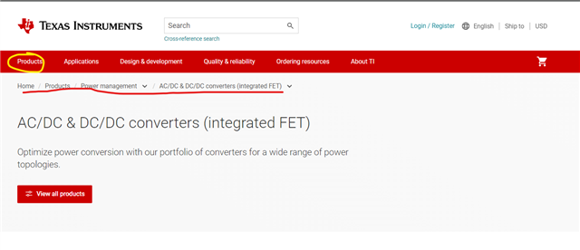

  • Hi Vera,
    Thank you for reaching out.  The LM5180 is a good choice especially if your high output voltage needs output regulation. TI has other flyback devices, and you can choose from at the TI.com by click Products tab, then get to the page of AC/DC & DC/DC converters (integrated FET):
    Then scroll down, you can see the Isolated section, under which there is the flyback products summary page. You can choose a suitable part there.
    Hope this helps.
