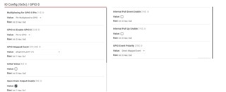

         Thanks for your reply. Now I have got the TPS25751 EVM and try to config the GPIO_0 for Plug Event. The following is my config. We use a 10k resistor pull up the GPIO_0 to 3.3V. When I inserted and removed the tablet the GPIO_0 always 3.3V. Is there any configuration I have missed?

  • Hi Aiden,
    GPIO0 may not have the resistor populated on the EVM, hence why it was not working.
    Register 0x1A Status Register can provide more information on the connection. See section 3.8 from the technical reference manual.
