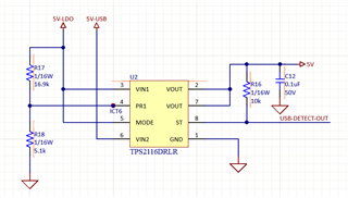

This is my schematic and I wish to connect the status pin to MCU which supports max 4.1V on any GPIO line.
1. How best to achieve this? when both my inputs are 5V.
2. What would happen if both VIn1 and Vin2 are connected and are at the same voltage levels, what would be the status on ST pin?
