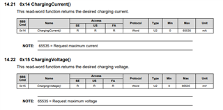

If the BQ40z50 R2 in my battery pack is connected to my host processor . How my processor will know how much current it need to send from the charger to the battery pack?
Is there any register or register bit Host processor has to read to know the desired current from the BQ40z50 R2 IC?
