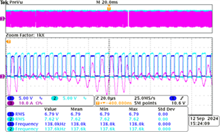

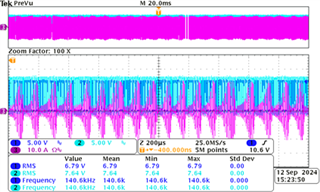

As stated in the title, the inductor current fluctuates significantly at full load output. What is the cause of this?

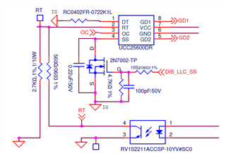

Can be referenced by the following two figures.
input voltage:405V,output voltage:580V,output power:2400W,topology:full bridge LLC
K=7,Lm=175uH,Lr=25uH,Cr=0.06uF

    In your scope plot it looks like the oscillator frequency and load current is changing.  Your voltage loop looks like it is not stable.
    I would recommend checking the voltage loop with a network analyzer to check and reset your phase an gain margin.
    You need more than 45 degrees of phase margin to ensure stability and greater than 3 dB of gain margin.  Once you re-compensate your voltage loop this issue should go away.
