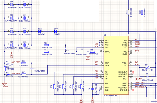

We have some 2S battery packs with BQ40Z50-R2 v2.08 that works fine. But there are some where there is serious imbalance (0.4V) between the cells. The circuit is similar to the EVM circuit.
To be free of previous error, I started a new config file (with firmware 2.08). The chemistry is set, the learning cycle was done, and the RA tables got updated. The cell balancing is enabled during rest and sleep too.
The packs are in rest now since two days, with CB is on. Cell 1 is at 3863mV, Cell 2 is at 4291mV.
But in BQ Studio, I see that "Cell 1 Current" and "Cell 2 Current" values are constantly shifting between 0 and -20mA. The imbalance between the cells remained the same after two days of balancing.
In this situation, cell 1 should not be discharged at all by the internal mosfet, right?
The config file is attached.

    A quick log file is attached, both cell currents jumps back and forth.The sense resistor is 1mOhm.
    CB_log.zip
    Because of some special requirements we are using 180oHm series resistors and two schottkey diodes. But those components should not really affect the cell balancing much except the maximum discharge current I think.
  • Hi Kovacs,
    Thank you for the log file, we will begin looking it over. Can you please confirm if the 8 cells in the image above are the only cells in use, along with why the VC3 and VC4 pins are not in use? Can you please give more information about the cell orientation?
    Anthony
  • Hi Anthony,
    This is a 2S6P pack. The 4 remaining cell is in an other PCB that's not shown in the picture above. Sorry, I should mention them already. So the total charge per series cells are around 10700mAh.
    VC3 an VC4 is tied to VC2 according to 8.3.5.4 point of the datasheet.

    I realized today, the jumping cell current values caused by the presence of the charger circuit that's part of the connector for the pack. It seems like the circuit tries to do something if there is voltage on it's output... I should have realized this sooner.
    So I think reducing "Relax Balance Interval Timer" is no longer needed.
    Thank you for your help!
