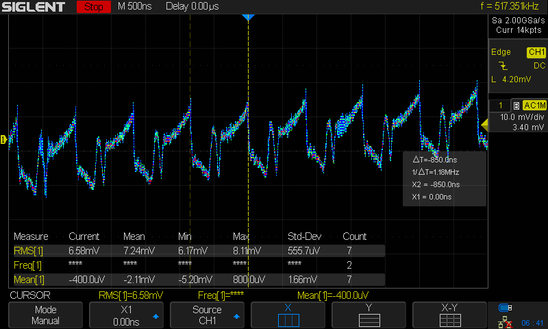

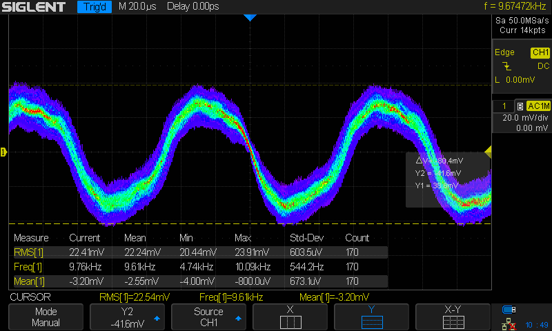

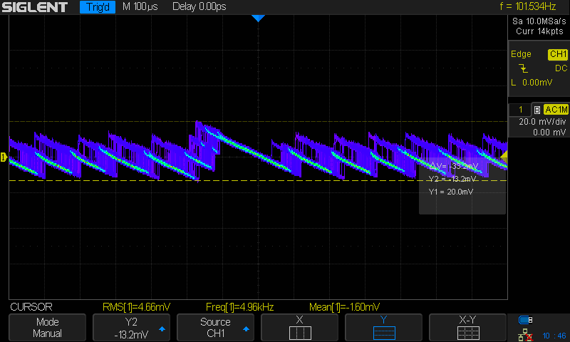

I'm validating the design and layout of a 20V to 12V buck converter using the TPS62932, and am observing some unexpected behavior on the voltage output. At low loads (0-200mA) the voltage ripple shape looks as one would expect, with the ~30mVpp making somewhat of a sawtooth at a lower frequency due to PFM. When the load is increased to 250mA and above, one can observe a large, ~80mVpp sinusoidal waveform at about 10kHz. If zoomed in, you can see that the 10kHz waveform is made up of the normal looking ripple at 1200kHz. I am trying to chase down the source of this large, low frequency ripple.
I assume that this behavior is somehow related to the buck converter entering DCM mode, but I am unsure if this behavior is to be expected or not. It doesn't effect our final use-case apart from an audible whine, but I wanted to double check if this is intended or not.

AC Coupled waveform with no load:
AC Coupled waveform with 500mA load:
AC Coupled waveform with 500mA load, zoomed in:

  • Hi Nicolas
    As the load decreases, the device enters into DCM, and when load is even smaller, it enters into PFM, to have higher efficiency under light load. The Vo_ripple is larger under light load and the frequency decreases. This is normal. The TPS62933F operates under CCM mode across all load range, so there is no larger Vo_ripple and no potential to have audible noise due to the decreased fsw. But the light load efficiency is lower.

    Thanks for the reply. The reason this throws me off is that the ripple grows in size as load increases, not as load decreases. I.e. at no load, we have 30mA ripple. At 500mA load, we have a sinusoidal 80mV ripple, which increases to almost 100mA at 2A load. The large ripple is also a constant frequency (~9.5kHz) across all loads, not adjusting to match load. This goes against the expected behavior from PFM.
    I did stumble across the thread linked below where another user had this issue and traced it back to the spread-spectrum feature, which modulates at the exact frequency I am seeing on the ripple. I also found a TI whitepaper that seems to confirm this is related to the spread spectrum implementation, specifically saying that the spread-spectrum feature will often leave a voltage ripple on the input and output at the exact modulation frequency. Leaving those links here for others who may come across this thread. I have the TPS62933F on the way to check if the ripple disappears.

  • Hi Nicholas
    The ripple should be caused by the spread spectrum, the modulation frequency is fsw/128, TPS62933F has no spread spectrum, should be able to solve your problem.

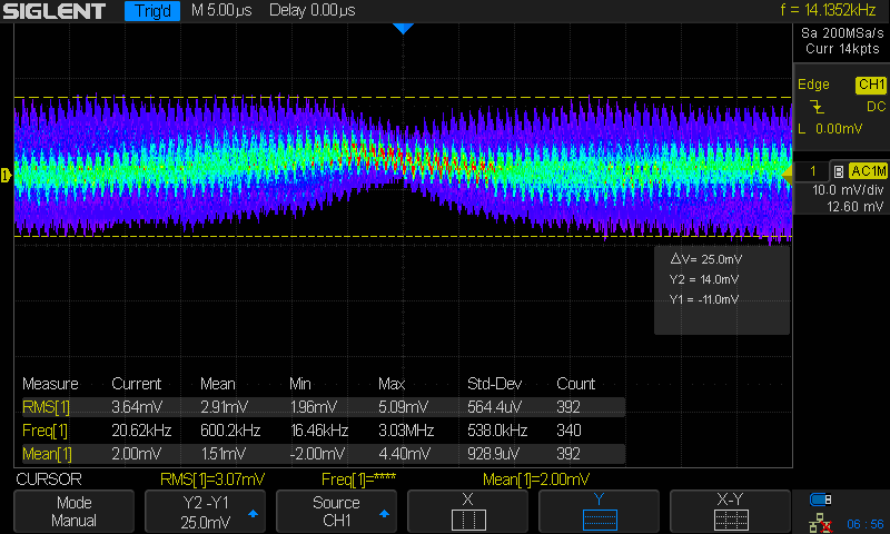

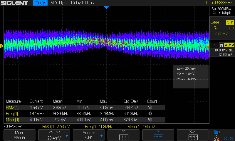

  • Thank you for the reply - received samples of the TPS62933F and can confirm it solved the issue. Scope shots are attached for others who may stumble across the thread. Ripple is now between 20-25mA across all load conditions. If possible, I'd suggest adding a statement to the datasheet mentioning this behavior, since it is not mentioned anywhere despite TI having a whitepaper specifically about it.
    AC Coupled Waveform with no load:
    AC Coupled Waveform with 2A load:
