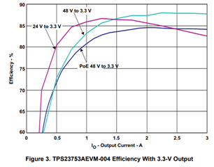

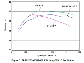

    Thanks for your reply. I did not have test experience with TPS23758 at 3.3V. I could find two efficiency data with TPS23753A. Among them, TPS23753AEVM-004 has a slightly better efficiency.
    TPS23753AEVM-002, POE70P-33L or 835-01045FC was used:
    TPS23753AEVM-004, HA3801-BL or 835-01040FC was used:

    Thanks for confirming load regulation issue.
    Based on the TPS23753AEVM-004 3.3V output test data, HA3801-BL or 835-01040FC is recommended with better efficiency.
