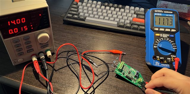

I am an engineering student and recently designed my first 4S BMS PCB using the BQ7791502 IC, based on the BQ77915 EVM design. When testing the PCB similarly to the EVM—by connecting a power supply to the battery terminals and using a 10K resistor as a load—I encountered an issue where the DSG FET continuously shuts off, despite the cell voltage sense inputs (VC1-5) showing around 4.0V, which is above the undervoltage threshold of 2.9V. Additionally, I noticed that the CHG FET does not turn off even when I turn up the supply voltage such that the cell voltages rise above the overvoltage threshold.
I'm not sure what's causing these problems and would appreciate any guidance or troubleshooting steps to help diagnose what might be wrong with my PCB. I've attached my schematic to this question and I am willing to attach my .PcbDoc file if it will help. (This is also my first thread on this site, so any pointers for future questions would also be appreciated!)

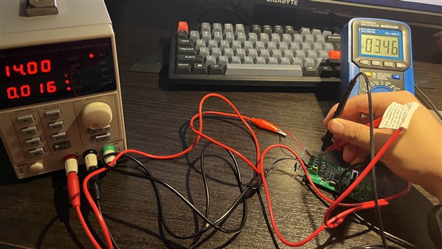

  • Hi Max,
    Thanks for replying, I measured the voltage of the battery connectors (e.g. probed 1 and 2 of connector J1) as well as the voltage across the capacitors C3-C6 as they would be parallel to the batteries. Setting my DC power supply to 14V and 1A, the voltage of each cell would be ~3.5V, which is what I observe when probing the connectors. I've attached an image of my testing setup. Also the LEDs were included in the EVM schematic, and are supposed to indicate that cell balancing is occurring.
    I fear it may be a layout issue but I'm not sure what to check.

  • Hi Max,
    I'm currently testing with a 10K resistor load connected to PACK+ and PACK-. I've attached a video to better show what I'm seeing. When measuring the voltage across PACK+ and PACK- I first see approximately the source voltage for a few seconds (~14V in this case), but then the output voltage drops to 120mV which is when I assume the DSG FET turns off.

  • Hi Max,
    When powering on the device without any load, I observe a decreased output voltage, but not to the extent as with the load attached. I observe ~12V when probing the PACK+ and PACK- test points without a load attached.

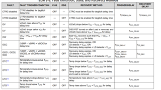

  • Hi Felix,
    Without a load the PACK- node is floating, so the DS voltage of the FETs being 0V does not necessarily mean that they are conducting.
    Since both FET pins are turning off, I'm more inclined to think that there is a current fault triggering. I'm curious, if you start the pack with a load, wait for the FETs to turn off, then remove the load, does the device recover?
