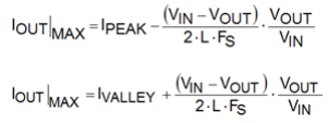

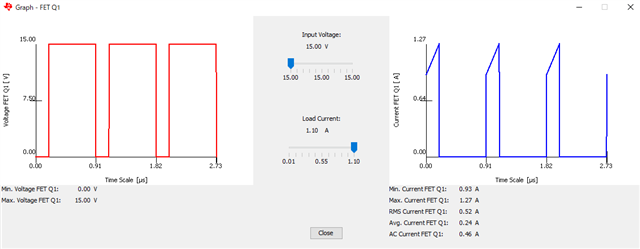

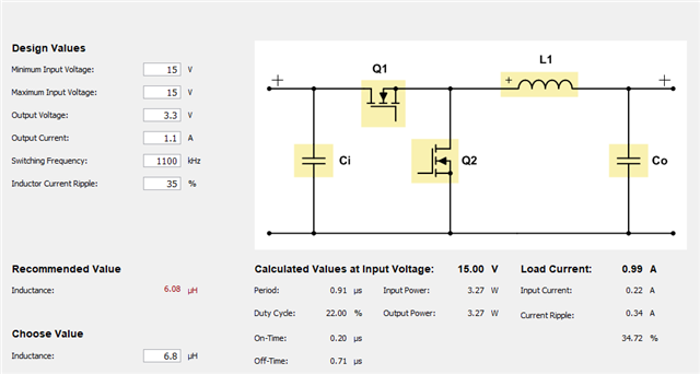

LMR54410 is limited to 1.0A. But my customer is trying to use 1.1A. I know this is not recommended by TI, but please provide your opinion if the LMR54410 can be used under the following conditions:
  • Vin (max) = 15V
  • Vout = 3.3V±2%
  • Iout = 1.1A (constant)
In my understanding, the DC/DC constant current is limited  by SOA.
