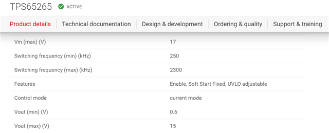

    I had a look at suitable regulator today and I also found the TPS65265 which would be an interesting candidate to replace the regulator for the 3.3V(4-5A max), the 5V(1A max) and the 9V(1A-1.5A max).
    The only thing I couldn't find is the maximum recommended output voltage.

  • Hi Stephan,
    For your questions, pls see my below answer:
    1. Most of MVB's products use two control methods: D-CAP and Current Model. Due to the compensation network inside the chip, the D-CAP control method has certain restrictions on the output voltage to ensure stability. The loop of Current Mode is different from D-CAP, and the output voltage range is relatively wider.
    2. For TPS65265, the max Vout is 15V. Pls see the product folder for more details.
    3. FCCM is generally a light load mode of chips using current mode control. This mode means that the chip will not reduce the frequency under light load conditions, the inductor current is allowed to reverse, and the chip continues to work at the set frequency.
    Hope these are helpful. Thanks.
