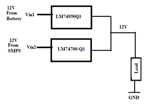

1. I need  Altium design files for LM74930Q1EVM to expedite my design.
2. Let me know following configuration is correct?
I wanted to design diode ORing controller for Two different 12V power sources. One source  12V DC is from Automotive battery and other 12V from SMPS . Output from battery source need all protections , however 12V output from SMPS  needs only reverse polarity protection. So could I use LM74930-Q1 for battery output and LM74700-Q1 for SMPS output as per below configuration.
