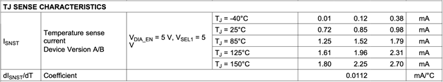

    The TJ sense accuracy gets worse as the temperature (SNS output current) gets lower as well. Please use the TJ SNS limits of TPS1HB08-Q1 as a design guide. The TJ and part temperature take some time to settle due to the part self-heating, increased package temperature, etc as well as the SNS settling time itself (though this is very quick) - Figure 2.1 in SLVAEX0 gives an idea on how long this takes.
    The part-to-part variation should be captured relatively well in the TPS1HB08-Q1 TJ SNS specs/

    From the TPS1HB08-Q1 numbers it seems that a 1.8 mA SNS current could indicate anywhere between 86C and 150C (based on the "max" number for 85C and the "min" number for 150C).
    (table from page 7, SLVSE16C –MAY 2019–REVISED JANUARY 2020)
    It seems that that software will have to be calibrated for each part to get useful measurements.
    Does TI have a recommended method of creating a known TJ condition in order to calibrate the SNS output?
    Maybe increasing load until thermal cutout and calibrating the last SNS reading before thermal cutout as 150C?
    Sam

    What purpose will you be using the temperature sense for? I would not recommend calibrating by when the device enters thermal shutdown unless you are using the temperature sense to warn of impending thermal shutdown, as the minimum thermal shutdown temperature is 160C, so it might be higher.
    I would instead recommend calibrating the temperature sense by calculating what the SNS current should be at each ambient temperature during your production test (or whenever you will be calibrating this), then correlating those values with the SNS current with no load in your calibration.
    Does that sound like it would work for you?
