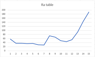

Hi,I used the BQ40Z50-r2 module on a 2S1P battery pack and found that the SOC calculation for a single full charge discharge was accurate. However, when I discharged the fully charged battery to about 20% SOC, I stopped discharging and let it sit for more than 18 hours before discharging again. I found that the SOC would jump to 0. I tested three batteries and found that they jumped to 0 at 9%, 7%, and 8%, respectively. After checking the logs, it was found that the full charge capacity FCC also jumped by about 200mAh after jumping to 0. It seems that the FCC estimation error occurred during the static process. Please help me confirm what the problem is. Attached is my. gg.csv configuration file

    I collected the logs recorded by Battery Management Studio. The operation steps are to use a 6A discharge current to stop at around 15% when the battery is fully charged, let it stand for about 3 hours, and then continue using 6A discharge. Upon checking the logs, I found that the voltage reached the cutoff voltage of 2700mv at 9% SOC, triggering a 0 jump. I analyzed three cases of batteries and found that one common feature is that the battery level is low (within 20%) and this phenomenon occurs when the temperature returns to room temperature before discharging. It is likely that the impedance of the battery cell changes after the temperature changes, and the estimated impedance is inaccurate. I have searched for relevant information about this, please help me answer a few questions:

  • Hello Ian,
    The reason for the jump in SOC is because of the abnormal Ra table that is learned on the gauge. At grid point 8 there is an abnormal jump in the Ra table which is not expected. This causes the gauge to overestimate the true internal resistance of the battery which causes the gauge to not accurately report SOC.
    The battery does reach a high temperature during discharge but that does not affect this too much since there is a long relaxation period afterwards, during relax the temperature returns back to normal and FCC updates.
    I would recommend first running the GPCRA tool to fix the Ra table for your battery: https://www.ti.com/tool/GPCRA0
    This should give you much better SOC reporting.
