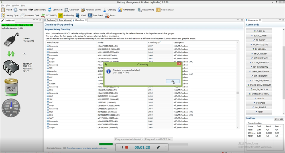

BQ27542EVM: Some bq27542-G1 samples are in a state where the chemistry or data memory can't be programmed
Guru 29720 points
Part Number: BQ27542EVM
Other Parts Discussed in Thread: BQ27542-G1, BQSTUDIO
Hi Team,
My customer is mass-producing the application using bq27542-G1.
During the manufacturing process, some samples are in a state where the chemistry or data memory can't be programmed.
It is not clear why this is the case in their manufacturing process, but programming the Golden Image returns the samples to a state that it can be programmed normally.
Attached files are dffs files that are exported from NG sample and Normal sample.
Note) I couldn't attach dffs file on this thread so the extension is changed from df.fs to txt.

Do you know what is happening in the NG samples?
Yaita
    Is it possible that the devices are sealed? Are you able to communicate with the devices and program the values using bqStudio?
    Robert.
  • Hi Robert-san,
    Thank you for your reply.
    I attached the capture that chemistry couldn't be programmed by bqStudio.(Data memory couldn't be programmed too.)
    On the other hand, we could read Data memory without error..
    I believe the following capture shows the device isn't sealed.
    Yaita
    It looks like you are using a very out-of-date version of bqStudio. Please upgrade to the latest TEST version of bqStudio here
    Robert.
