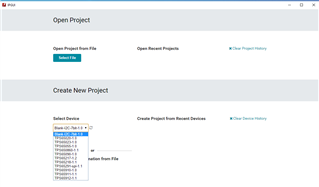

I am trying to configure the registers for PMIC TPS65224-Q1 using IPGUI tool but I couldn't find this part number in the tool is there a specific version from IPGUI supporting this part number?
Hi Ahmed,
TPS65224-Q1 is not using IPGUI tool. Also be noted that memory of the PMIC device is OTP (one-time-programmable) so new config cannot be pushed in.
