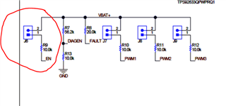

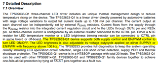

    For EN pin, can i connect this pin directly to controller pin 5V to ON/OFF with 100Hz frequency ??
    Yes, you can use the EN pin or PWM pins to apply PWM dimming. 100Hz can be used for some applications but higher PWM frequencies will help to remove visible flicker. TI typically recommends a 200-Hz PWM signal with 1% to 100% duty cycle input for brightness control.

    2. Regarding EN pin..
    In order to apply PWM dimming to the EN pin you must remove the shunt at J6 and apply your PWM signal to pin 1 of the J6 header. You should see the LEDs turn off as you remove the J6 shunt.

    1. Is that okay to give PWM to EN pin ? Does it mentioned in data sheet? If i can give PWM to En, what happens to PWM pins? should we let them float ? How much maximum PWM frequency that can be given to EN pin? does same as PWM pins like 200Hz ?
    2. Is it okay to pass 60Hz Frequency to the EN pin to achieve the LED blinking at 60 Hz frequency ?
    3. Why i can't be able to make the EN pin low when i connect it to controller pin and make the controller pin low.. (The LEDs are still glowing when i connected the EN pin to controller GPIO pin and made the GPIO pin low (0V from GPIO pin)).

  • Hi Tex,
    Yes, you may apply 200Hz PWM frequency to the EN pin to control the LED dimming. The PWM pins should be pulled to the battery voltage with a 10k pull-up resistor as shown in the EVM.
    You can apply lower PWM frequency if you want to achieve a visual blinking effect. However, this may interfere with your dimming function resulting in an inconsistent brightness. If you need separate control signals for LED brightness control and a lower frequency blink function you can use the PWM pins for your dimming and use the EN pin for the blink function.
    Did you remove the shunt at J6? If you are measuring 0V at your MCU pin and 9V at your EN pin there must be a connection issue. Please provide clear images of your test configuration including all connections to the EVM and MCU. If you are measuring these pin voltages with an oscilloscope, ensure you have selected "DC coupling".

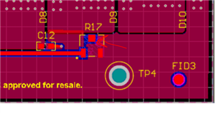

    Actually 8 LEDs should turn ON when the forward is ~24V at OUT1, But all the LEDs are turning ON at 20V and when we try to give input voltage of 21V all LEDs are turning off and 0V at OUT1.. throughout this current consumption is 3mA
    Please Look at the below image..
    This is the 2D Design which is given in EV Kit Guide.. If i change any resistance value, that will be modified in the middle pin but that is connected nowhere and 3rd pin where i'm getting 485Ω is connected to GND.. so, as per the connections in EVKIT ICTRL2 value is 485Ω.. Is My doubt correct or should need to use that R17 resistor in a different way to change the value ?
    Please suggest more debugging steps..
    Kind regards,
    Tex
  • Hi Tex,
    I have verified the R17 connection on my EVM and you are correct, there is a bug in the potentiometer routing and the wiper is left floating. My apologies for the confusion, in this configuration the Rctrl2 (R17) value is fixed at 500Ω. I will submit to revise the EVM layout and correct this bug.
    I recommend one of the two following solutions:
    Option 1.) Remove J12 shunt and connect 165Ω resistor from J12 terminal pin 2 to ground. This can be done easily with a through-hole resistor.
    Option 2.) Keep J2 shunt populated and replace R3 with a 2.3Ω resistor as calculated by R17 = 500Ω
    Please let me know if this works.

  • Hi Zach,
    Thanks for your confirmation,
    I tried both the options one after another,
    Also tried soldering R17 Resistor on the LED board and checked but still, when the input voltage is more than 21V the OUT1 string is turning off.

    Then can we keep the resistor unchanged for all voltage values ?
    How is that the circuit is taking only 24V while 30V is the input power supply with your settings which are shared previously ?
    One small doubt with respect to my personal design.. please try to suggest if you know about this kind of circuits..
    The distance between Micro controller and TPS92633-Q1 IC is 5 meter or more.. i'm connecting the controller GPIO pins (6 pins) to this IC EN/PWM pins so, i might need to use a 5 meter cable..
    Is there any best way to do this task ? like is there any TI integrated circuits which can help me to do this ?
    Tex
  • Hi Tex,
    I recommend using Equation 11 in the TPS92633-Q1 datasheet to determine your Rresx value for each channel.
    My series LED load produces a total forward voltage of 24.66V for a current of ~70mA.
    I'm connecting the controller GPIO pins (6 pins) to this IC EN/PWM pins so, i might need to use a 5 meter cable.. Is there any best way to do this task ? like is there any TI integrated circuits which can help me to do this ?
    I am not sure what the cable-driving capabilities of your microcontroller are. If this is a TI microcontroller, you may create a new thread directed to the microcontrollers E2E forum and the proper team will be able to provide support.
    I am aware that TI offers cable drivers and other signal conditioners, however these are typically only necessary for high-speed data lines.
